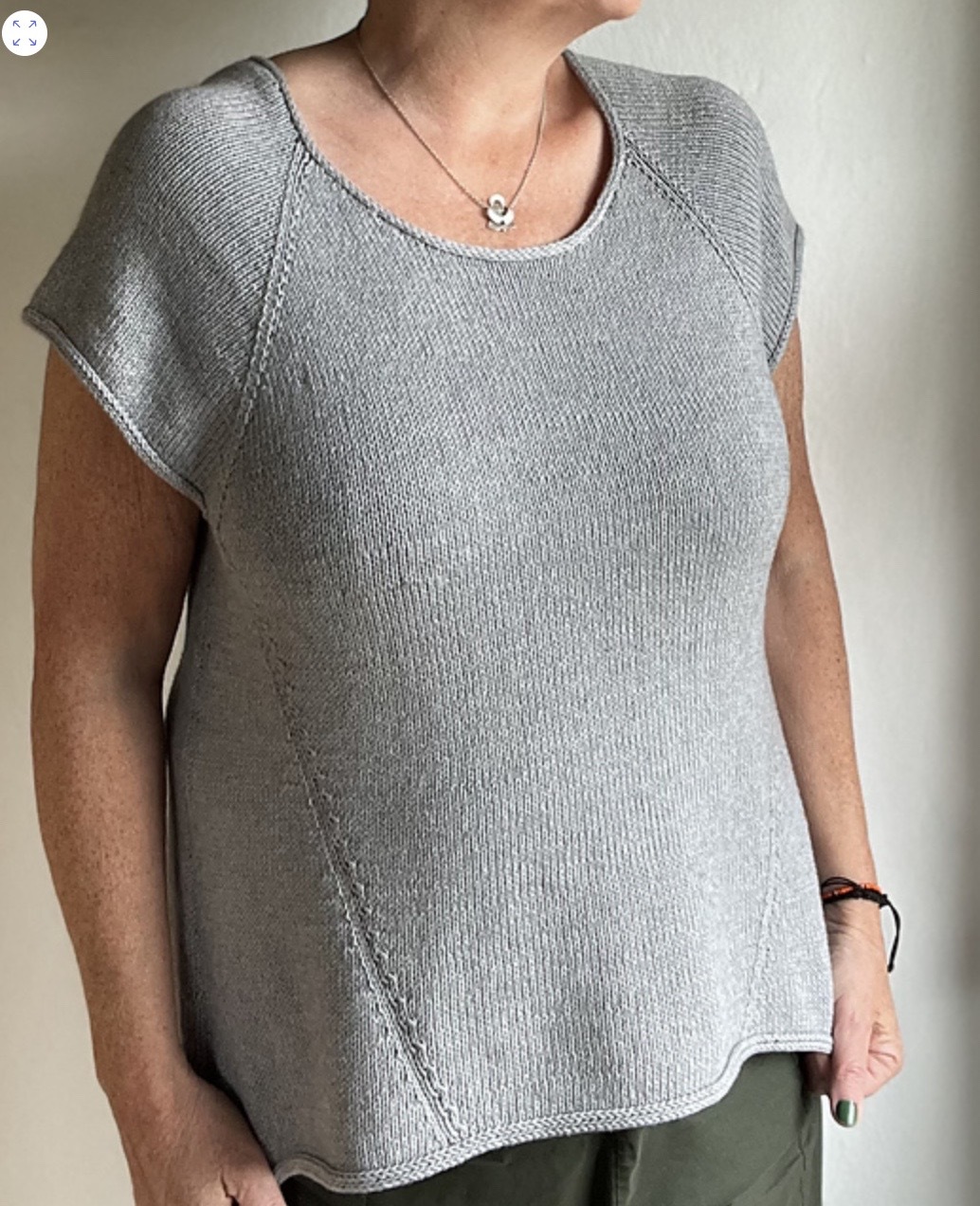

    Перевод описания на русский язык.
    GREEN-tee is knitted top-down with a short raglan sleeve. It is knitted in stockinette stitch, where the raglan lines continues down through the body, forming the oblique cut. The body has a little A-shape for a more loose fit around the hem.
    All edges are worked as I-cord bind off. The model is seamless.
    Materials
    CONCEPT Cotton-cashmere or similar sport weight cotton-yarn: 170 yd (155 m) / 50 g.
    300 / 300 / 350 / 400 / 400 / 400 g
    32” (80 cm) circular needle size US 2.5 (3 mm)
    Stitch markers
    Gauge
    Before wash: 26 sts & 36 rows in stockinette stitch with needle size US 2.5 (3 mm) = 4” (10 cm).
    After wash and blocking: 25 sts & 36 rows = 4” (10 cm)
    Measurements
    Bust circumference: 38” (97 cm) / 41.5” (105 cm) / 44.5” (113 cm) / 48.5” (123 cm) / 52.5” (133 cm) / 56.5” (143 cm)
    Hem circumference: 44.5” (113 cm) / 47.5” (121 cm) / 51” (129 cm) / 54.5” (139 cm) / 58.5” (149 cm) / 62.5” (159 cm)
    Length: 23” (58 cm) / 23” (59 cm) / 23.5” (60 cm) / 25” (63 cm) / 25.5” (65 cm) / 26” (66 cm)
